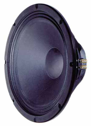

Динамик НЧ профессиональный Visaton BGS 40/8

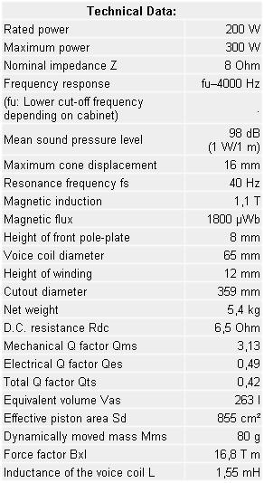

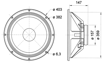

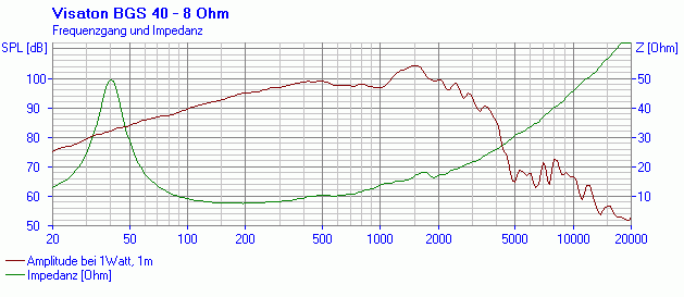

40 cm (15") woofer with hard cone suspension for P.A.
BGS408OHMпо запросу
systems, stage monitors and musicians speakers. Solid aluminium die-cast basket for front- or rear baffle mounting. High efficiency and high power handling due to large magnetic drive with vent and 65 mm voice-coil.
