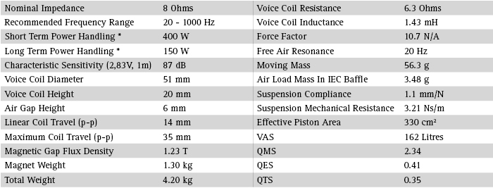

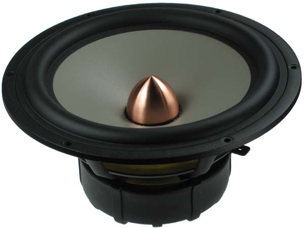

The extremely stiff cone made from aluminium/magnesium alloy gives tremendous bass precision.
2” diameter high temperature voice coil with black anodized aluminium coil former for high power handling and reduced power compression. Heavy copper rings mounted above and below the T-shaped pole piece reduce non linear and modulation distortion and increase overload margin. Extremely stiff and stable injection moulded metal basket keeps the critical components in perfect alignment. Large windows in the basket both above and below the spider reduce sound reflexion, air flow noise and cavity resonance to a minimum. A solid copper phase plug enhances the performance of the copper rings and improves heat conduction away from the pole piece. Gold plated terminals mounted on a glass fibre reinforced plate to reduce contact resistance and improve reliability.
