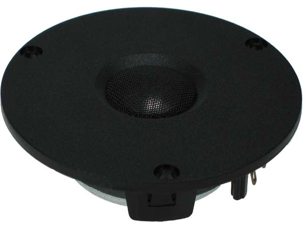

Динамик ВЧ SEAS H0414-08 (19TAF/G)
19mm High Fidelity dome tweeter with smooth, extended frequency response.
Выбираем схему BMS для заряда литий-железофосфатных (LiFePO4) аккумуляторов

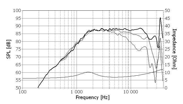

Aluminium diaphragm suspended by a specially designed soft Sonotex surround which allows a low fundamental frequency. Injection moulded chassis in high grade glass fibre reinforced plastic keeps the moving parts in perfect alignment and provides good coupling to the cabinet. Fine mesh grid protects the diaphragm and carries a phase plate which compensates for a slight axial roll off towards 20 kHz. Voice coil windings immersed in magnetic fluid increase short term power handling capacity and reduce the compression at high power levels.
