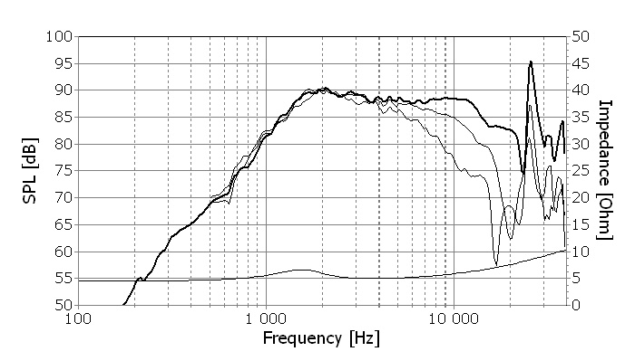

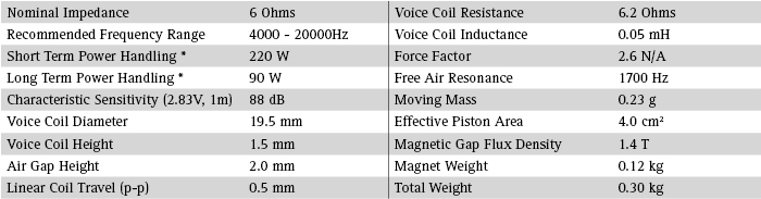

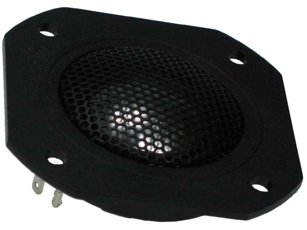

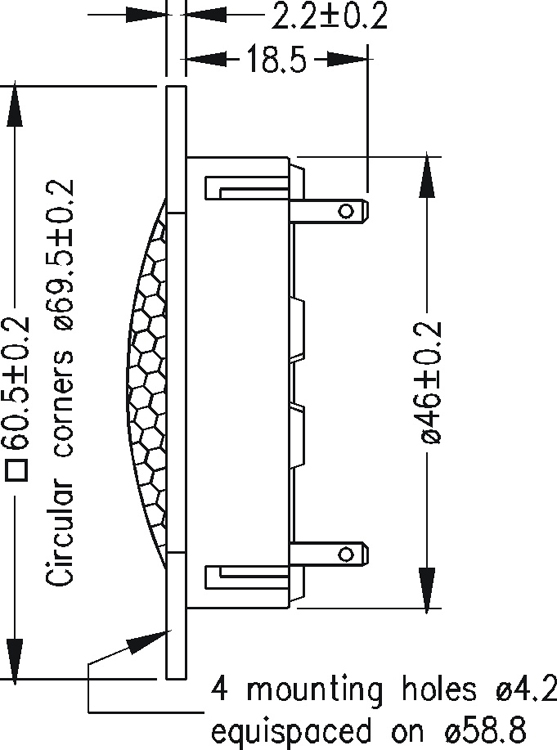

Compact neodymium magnet tweeter with a square chassis for high quality speaker design in small cabinets or automobiles.
Aluminium/magnesium alloy diaphragm with pistonic behaviour throughout the
audible frequency range, resulting in a good dispersion also above 10kHz. Sonotex surround for excellent mechanical linearity. A Hexagrid protects the diaphragm, and supports a phase plate which compensates
for a slight axial roll off towards 20 kHz. The construction of the magnet system results in very low magnetic stray fields since the magnet is enclosed in a soft steel housing. Thus, this unit is immediately ready for Audio-video systems. The voice coil is immersed in magnetic fluid, allowing high power handling capacity
and simplified crossover design.
