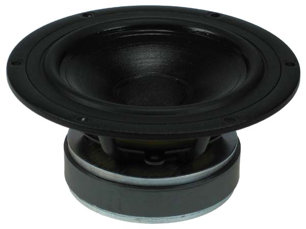

Динамик СЧ/НЧ SEAS H1216-08 (CA15RLY)

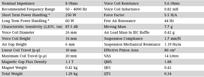

15 cm (5’’) cone driver, developed for use as a long throw high fidelity woofer or woofer/midrange unit.

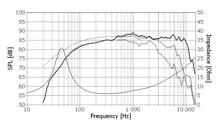

Classical coated paper cone that gives a smooth extended frequency response with a controlled roll off.
Large magnet system together with a very long and light weight CCAW voice coil allow good coil excursion with low distortion and good transient response.

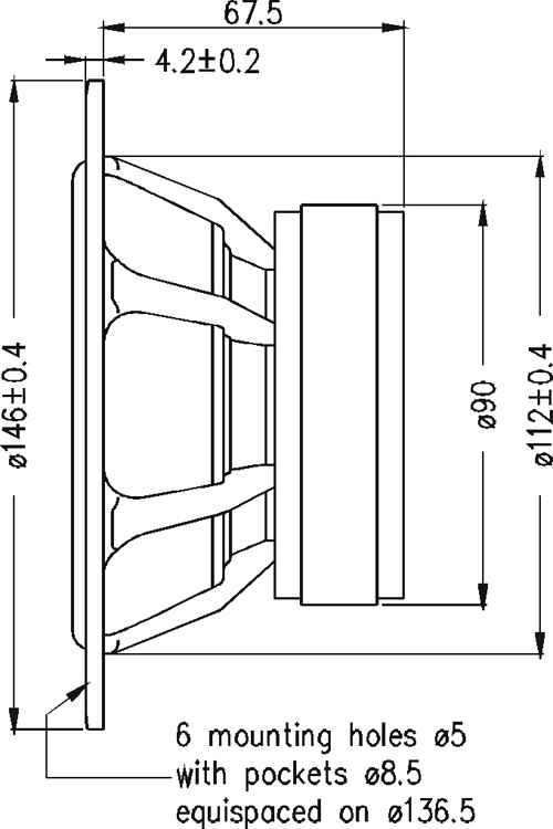

Extremely stiff and stable injection moulded metal basket, that keeps the critical components in perfect alignment. Large windows in the basket both above and below the spider reduce sound reflection, air flow noise and cavity resonance to a minimum.
