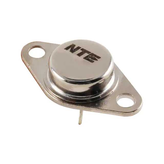

Наименование модели: NTE274
Производитель: NTE Electronics
Описание: Транзистор, NPN, 80 В, 8 А, TO-66
data sheetСкачать Data Sheet
Краткое содержание документа:
NTE274 (NPN) & NTE275 (PNP) Silicon Complementary Transistors Darlington Power Amplifier, Switch
Description: The NTE274 (NPN) and NTE275 (PNP) are silicon complementary Darlington transistors in a TO66 type case designed for general purpose amplifier, low­frequency switching and hammer driver applications.
Features: D High DC Current Gain: hFE = 3000 Typ @ IC = 2A D Low Collector­Emitter Saturation Voltage: VCE(sat) = 2V Max @ IC = 2A D Collector­Emitter Sustaining Voltage: VCEO(sus) = 80V Min D Monolithic Construction with Built­In Base­Emitter Shunt Resistors Absolute Maximum Ratings: Collector­Emitter Voltage, VCEO . . . . . . . . . . . . . . . . . . . . . . . . . . . . . . . . . . . . . . . . . . . . . . . . . . . . . . 80V Collector­Base Voltage, VCB . . . . . . . . . . . . . . . . . . . . . . . . . . . . . . . . . . . . . . . . . . . . . . . . . . . . . . . . . 80V Emitter­Base Voltage, VEB . . . . . . . . . . . . . . . . . . . . . . . . . . . . . . . . . . . . . . . . . . . . .
  • Collector Emitter Voltage V(br)ceo: 80 В
  • DC Collector Current: 8 А
  • DC Current Gain: 100
  • Количество выводов: 2
  • Полярность транзистора: NPN
  • Рабочий диапазон температрур: -65°C ... +200°C
  • Рассеиваемая мощность: 50 Вт
  • RoHS: да
