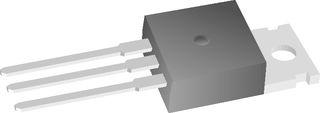

NTE152 (NPN) & NTE153 (PNP) Silicon Complementary Transistors Audio Power Amplifier, Switch
Description: The NTE152 (NPN) and NTE153 (PNP) are silicon complementary transistors in a standard TO220 type package designed for general purpose medium power switching and amplifier applications.
Features: D Good Linearity of hFE Absolute Maximum Ratings: (TA = +25°C unless otherwise specified) Collector­Base Voltage, VCBO . . . . . . . . . . . . . . . . . . . . . . . . . . . . . . . . . . . . . . . . . . . . . . . . . . . . . . . 90V Collector­Emitter Voltage, VCEO . . . . . . . . . . . . . . . . . . . . . . . . . . . . . . . . . . . . . . . . . . . . . . . . . . . . . . 90V Emitter­Base Voltage, VEBO . . . . . . . . . . . . . . . . . . . . . . . . . . . . . . . . . . . . . . . . . . . . . . . . . . . . . . . . . . 5V Collector Current, IC . . . . . . . . . . . . . . . . . . . . . . . . . . . . . . . . . . . . . . . . . . . . . . . . . . . . . . . . . . . . . . . . . 4A Emitter Current, IE .
  • Полярность транзистора: PNP
  • Collector Emitter Voltage V(br)ceo: -90 В
  • Transition Frequency Typ ft: 8 МГц
  • Power Dissipation Pd: 40 Вт
  • DC Collector Current: -4 А
  • DC Current Gain Max (hfe): 40
