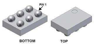

Max rDS(on) = 85m: at VGS = -4.5V, ID = -1A Max rDS(on) = 123m: at VGS = -2.5V, ID = -1A Max rDS(on) = 200m: at VGS = -1.5V, ID = -1A Occupies only 1.5 mm2 of PCB area Less than 50% of the area of 2 x 2 BGA Ultra-thin package: less than 0.65 mm height when mounted to PCB RoHS Compliant

  • Pin Configuration: G(1), S(2, 5, 6), D(3, 4)
