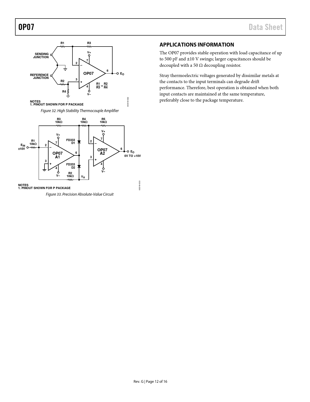

OP07 Data Sheet R1 R3 APPLICATIONS INFORMATION V+ SENDING
The OP07 provides stable operation with load capacitance of up
JUNCTION
to 500 pF and
7
±10 V swings; larger capacitances should be
2
decoupled with a 50 Ω decoupling resistor.
6 OP07 EO REFERENCE
Stray thermoelectric voltages generated by dissimilar metals at
JUNCTION 3 R2 +
the contacts to the input terminals can degrade drift
R1 R2 4 = R3 R4
performance. Therefore, best operation is obtained when both
R4 V–
input contacts are maintained at the same temperature, 032 preferably close to the package temperature.
NOTES 1. PINOUT SHOWN FOR P PACKAGE
00316- Figure 32. High Stability Thermocouple Amplifier
R3 R4 R5 10kΩ 10kΩ 10kΩ V+ V+ 7 FD333 R1 2 7 D1 E 10kΩ IN 2 ±10V OP07 6 E 6 OP07 A2 O A1 3 0V TO +10V + 3 + 4 FD333 4 D2 V– R2 V– 10kΩ VA
033
00316- Figure 33. Precision Absolute-Value Circuit Rev. G | Page 12 of 16 Document Outline Features Applications General Description Pin Configuration Revision History Specifications OP07E Electrical Characteristics OP07C Electrical Characteristics Absolute Maximum Ratings Thermal Resistance ESD Caution Typical Performance Characteristics Typical Applications Applications Information Outline Dimensions Ordering Guide
