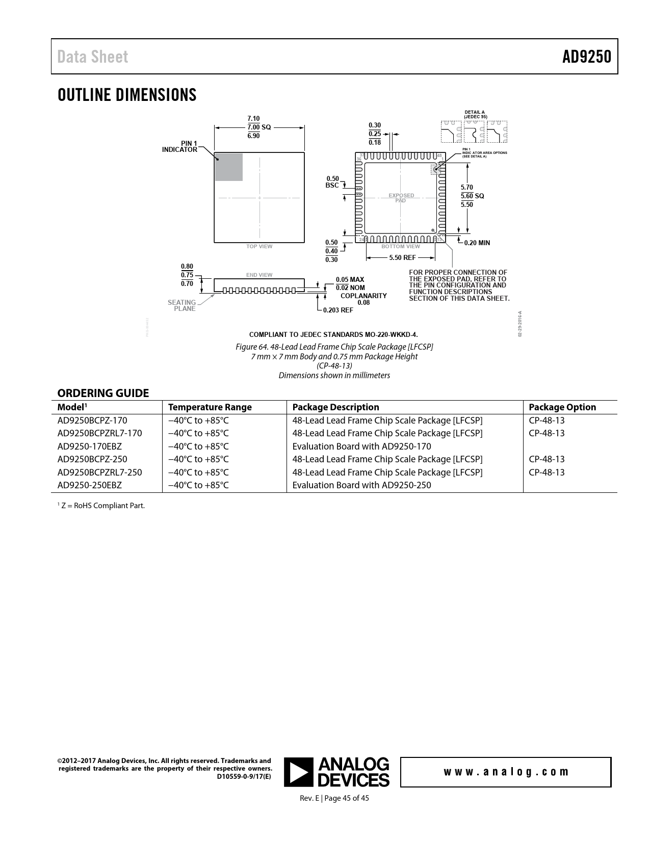

Data Sheet. AD9250. OUTLINE DIMENSIONS. DETAIL A. 7.10. (JEDEC 95). 0.30. 7.00 SQ. 0.25. 6.90. PIN 1. 0.18. INDICATOR
Data Sheet AD9250 OUTLINE DIMENSIONS DETAIL A 7.10 (JEDEC 95) 0.30 7.00 SQ 0.25 6.90 PIN 1 0.18 INDICATOR

Data Sheet AD9250 OUTLINE DIMENSIONS DETAIL A 7.10 (JEDEC 95) 0.30 7.00 SQ 0.25 6.90 PIN 1 0.18 INDICATOR PIN 1 INDIC ATOR AREA OPTIONS 37 48 (SEE DETAIL A) 36 1 0.50 BSC 5.70 EXPOSED 5.60 SQ PAD 5.50 24 13 0.50 0.20 MIN TOP VIEW BOTTOM VIEW 0.40 0.30 5.50 REF 0.80 0.75 END VIEW FOR PROPER CONNECTION OF 0.05 MAX THE EXPOSED PAD, REFER TO 0.70 0.02 NOM THE PIN CONFIGURATION AND FUNCTION DESCRIPTIONS COPLANARITY SECTION OF THIS DATA SHEET. SEATING 0.08 PLANE 0.203 REF A 52 -2016- 044 -0 29 G K P COMPLIANT TO JEDEC STANDARDS MO-220-WKKD-4. 02-
Figure 64. 48-Lead Lead Frame Chip Scale Package [LFCSP] 7 mm × 7 mm Body and 0.75 mm Package Height (CP-48-13) Dimensions shown in millimeters
ORDERING GUIDE Model1 Temperature Range Package Description Package Option
AD9250BCPZ-170 −40°C to +85°C 48-Lead Lead Frame Chip Scale Package [LFCSP] CP-48-13 AD9250BCPZRL7-170 −40°C to +85°C 48-Lead Lead Frame Chip Scale Package [LFCSP] CP-48-13 AD9250-170EBZ −40°C to +85°C Evaluation Board with AD9250-170 AD9250BCPZ-250 −40°C to +85°C 48-Lead Lead Frame Chip Scale Package [LFCSP] CP-48-13 AD9250BCPZRL7-250 −40°C to +85°C 48-Lead Lead Frame Chip Scale Package [LFCSP] CP-48-13 AD9250-250EBZ −40°C to +85°C Evaluation Board with AD9250-250 1 Z = RoHS Compliant Part.
