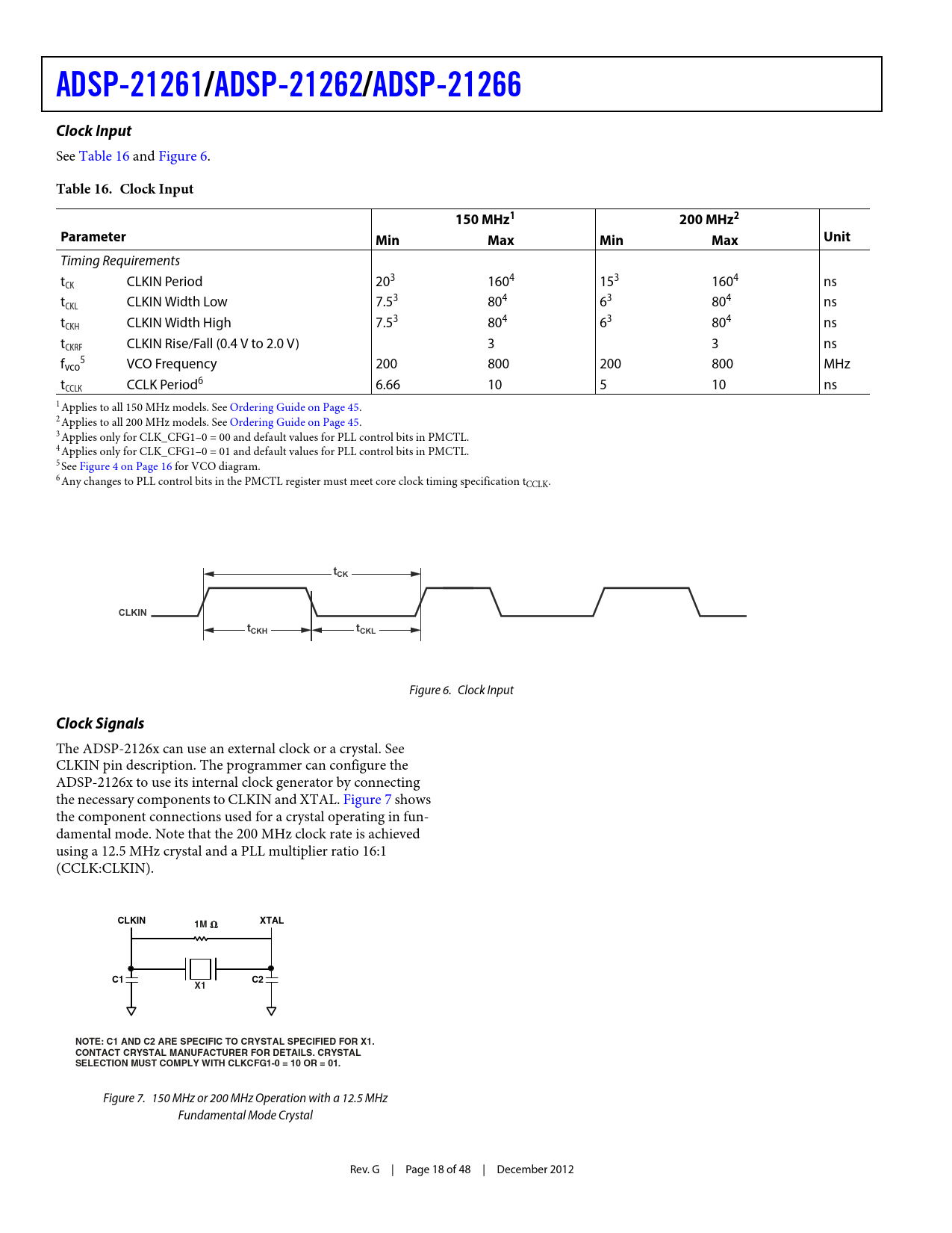

ADSP-21261/ ADSP-21262/ ADSP-21266 Clock Input
See Table 16 and Figure 6.
Table 16. Clock Input 150 MHz1 200 MHz2 Parameter Unit Min Max Min Max
Timing Requirements tCK CLKIN Period 203 1604 153 1604 ns tCKL CLKIN Width Low 7.53 804 63 804 ns tCKH CLKIN Width High 7.53 804 63 804 ns tCKRF CLKIN Rise/Fall (0.4 V to 2.0 V) 3 3 ns f 5 vco VCO Frequency 200 800 200 800 MHz tCCLK CCLK Period6 6.66 10 5 10 ns 1 Applies to all 150 MHz models. See Ordering Guide on Page 45. 2 Applies to all 200 MHz models. See Ordering Guide on Page 45. 3 Applies only for CLK_CFG1–0 = 00 and default values for PLL control bits in PMCTL. 4 Applies only for CLK_CFG1–0 = 01 and default values for PLL control bits in PMCTL. 5 See Figure 4 on Page 16 for VCO diagram. 6 Any changes to PLL control bits in the PMCTL register must meet core clock timing specification tCCLK.
tCK CLKIN t t CKH CKL
Figure 6. Clock Input
Clock Signals
The ADSP-2126x can use an external clock or a crystal. See CLKIN pin description. The programmer can configure the ADSP-2126x to use its internal clock generator by connecting the necessary components to CLKIN and XTAL. Figure 7 shows the component connections used for a crystal operating in fun- damental mode. Note that the 200 MHz clock rate is achieved using a 12.5 MHz crystal and a PLL multiplier ratio 16:1 (CCLK:CLKIN).
CLKIN XTAL 1M
C1 C2 X1 NOTE: C1 AND C2 ARE SPECIFIC TO CRYSTAL SPECIFIED FOR X1. CONTACT CRYSTAL MANUFACTURER FOR DETAILS. CRYSTAL SELECTION MUST COMPLY WITH CLKCFG1-0 = 10 OR = 01.
Figure 7. 150 MHz or 200 MHz Operation with a 12.5 MHz Fundamental Mode Crystal Rev. G | Page 18 of 48 | December 2012 Document Outline Summary Table of Contents Revision History General Description Family Core Architecture SIMD Computational Engine Independent, Parallel Computation Units Data Register File Single-Cycle Fetch of Instruction and Four Operands Instruction Cache Data Address Generators with Zero-Overhead Hardware Circular Buffer Support Flexible Instruction Set Memory and I/O Interface Features Dual-Ported On-Chip Memory DMA Controller Digital Application Interface (DAI) Serial Ports Serial Peripheral (Compatible) Interface Parallel Port Timers ROM-Based Security Program Booting Phase-Locked Loop Power Supplies Target Board JTAG Emulator Connector Development Tools Integrated Development Environments (IDEs) EZ-KIT Lite Evaluation Board EZ-KIT Lite Evaluation Kits Software Add-Ins for CrossCore Embedded Studio Board Support Packages for Evaluation Hardware Middleware Packages Algorithmic Modules Designing an Emulator-Compatible DSP Board (Target) Additional Information Related Signal Chains Pin Function Descriptions Address Data Pins as Flags Boot Modes Core Instruction Rate to CLKIN Ratio Modes Address Data Modes Product Specifications Operating Conditions Electrical Characteristics Package Information ESD Caution Maximum Power Dissipation Absolute Maximum Ratings Timing Specifications Core Clock Requirements Voltage Controlled Oscillator Power-Up Sequencing Clock Input Clock Signals Reset Interrupts Core Timer Timer PWM_OUT Cycle Timing Timer WDTH_CAP Timing DAI Pin-to-Pin Direct Routing Precision Clock Generator (Direct Pin Routing) Flags Memory Read—Parallel Port Memory Write—Parallel Port Serial Ports Input Data Port (IDP) Parallel Data Acquisition Port (PDAP) SPI Interface Protocol—Master SPI Interface Protocol—Slave JTAG Test Access Port and Emulation Output Drive Currents Test Conditions Capacitive Loading Environmental Conditions Thermal Characteristics 144-Lead LQFP Pin Configurations 136-Ball BGA Pin Configurations Outline Dimensions Surface-Mount Design Automotive Products Ordering Guide
