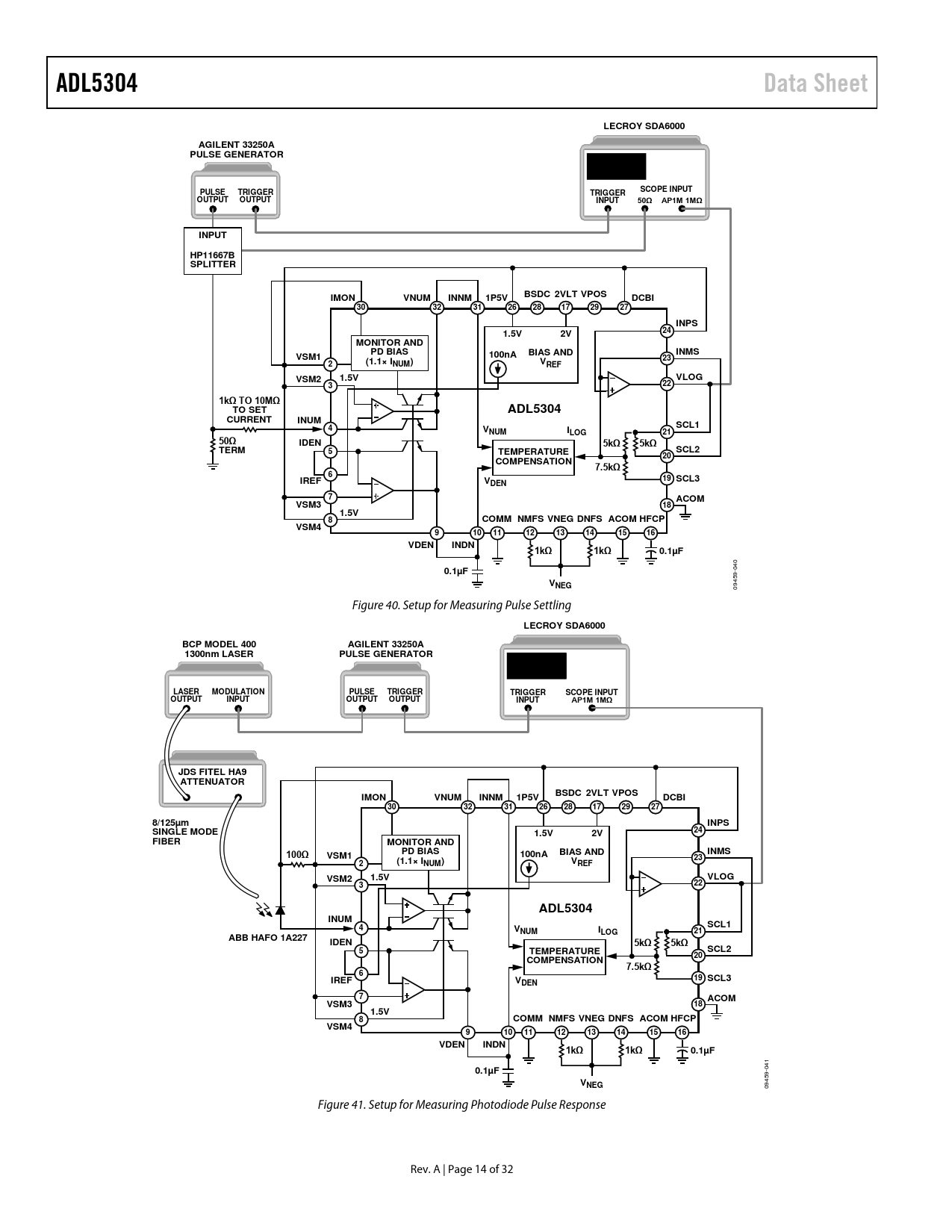

ADL5304. Data Sheet. LECROY SDA6000. AGILENT 33250A. PULSE GENERATOR. PULSE. TRIGGER. SCOPE INPUT. OUTPUT. INPUT. 50Ω AP1M 1MΩ
ADL5304 Data Sheet LECROY SDA6000 AGILENT 33250A PULSE GENERATOR PULSE TRIGGER SCOPE INPUT OUTPUT INPUT 50Ω AP1M 1MΩ

ADL5304 Data Sheet LECROY SDA6000 AGILENT 33250A PULSE GENERATOR PULSE TRIGGER SCOPE INPUT TRIGGER OUTPUT OUTPUT INPUT 50Ω AP1M 1MΩ INPUT HP11667B SPLITTER IMON VNUM INNM 1P5V BSDC 2VLT VPOS DCBI 30 32 31 26 28 17 29 27 INPS 1.5V 24 2V MONITOR AND PD BIAS INMS VSM1 100nA BIAS AND 23 2 (1.1× INUM) VREF VSM2 1.5V VLOG 3 22 1kΩ TO 10MΩ TO SET ADL5304 CURRENT INUM 4 SCL1 VNUM ILOG 21 50Ω IDEN 5kΩ 5kΩ TERM 5 TEMPERATURE SCL2 20 COMPENSATION 7.5kΩ 6 IREF 19 SCL3 VDEN 7 ACOM VSM3 18 1.5V 8 COMM NMFS VNEG DNFS ACOM HFCP VSM4 9 10 11 12 13 14 15 16 VDEN INDN 1kΩ 1kΩ 0.1µF

09459- Figure 40. Setup for Measuring Pulse Settling
LECROY SDA6000 BCP MODEL 400 AGILENT 33250A 1300nm LASER PULSE GENERATOR LASER MODULATION PULSE TRIGGER TRIGGER SCOPE INPUT OUTPUT INPUT OUTPUT OUTPUT INPUT AP1M 1MΩ JDS FITEL HA9 ATTENUATOR IMON VNUM INNM 1P5V BSDC 2VLT VPOS DCBI 30 32 31 26 28 17 29 27 8/125µm INPS SINGLE MODE 1.5V 24 2V FIBER MONITOR AND PD BIAS INMS 100Ω VSM1 100nA BIAS AND 23 2 (1.1× INUM) VREF VSM2 1.5V VLOG 3 22 ADL5304 INUM 4 SCL1 VNUM ILOG 21 ABB HAFO 1A227 IDEN 5kΩ 5kΩ 5 TEMPERATURE SCL2 20 COMPENSATION 7.5kΩ 6 IREF 19 SCL3 VDEN 7 ACOM VSM3 18 1.5V 8 COMM NMFS VNEG DNFS ACOM HFCP VSM4 9 10 11 12 13 14 15 16 VDEN INDN 1kΩ 1kΩ 0.1µF

09459- Figure 41. Setup for Measuring Photodiode Pulse Response Rev. A | Page 14 of 32 Document Outline FEATURES APPLICATIONS GENERAL DESCRIPTION SIMPLIFIED BLOCK DIAGRAM TABLE OF CONTENTS REVISION HISTORY SPECIFICATIONS ABSOLUTE MAXIMUM RATINGS ESD CAUTION PIN CONFIGURATION AND FUNCTION DESCRIPTIONS TYPICAL PERFORMANCE CHARACTERISTICS TEST CIRCUITS TERMINOLOGY THEORY OF OPERATION BASIC CONCEPTS OPTICAL MEASUREMENTS Decibel Scaling CIRCUIT DESCRIPTION Bandwidth vs. Current Noise vs. Current Filtering to Improve Noise and Dynamic Behavior Photodiode Bias Reference Outputs Buffer Amplifier Setting the Log Slope and Intercept Slope Inversion Log Ratio Operation APPLICATIONS INFORMATION USING THE ADL5304 Using the Adaptive Bias Summing Node Voltage Leakage VLOG Output Dynamic Response USING A NEGATIVE SUPPLY EVALUATION BOARD SCHEMATIC AND SILKSCREENS OUTLINE DIMENSIONS ORDERING GUIDE
