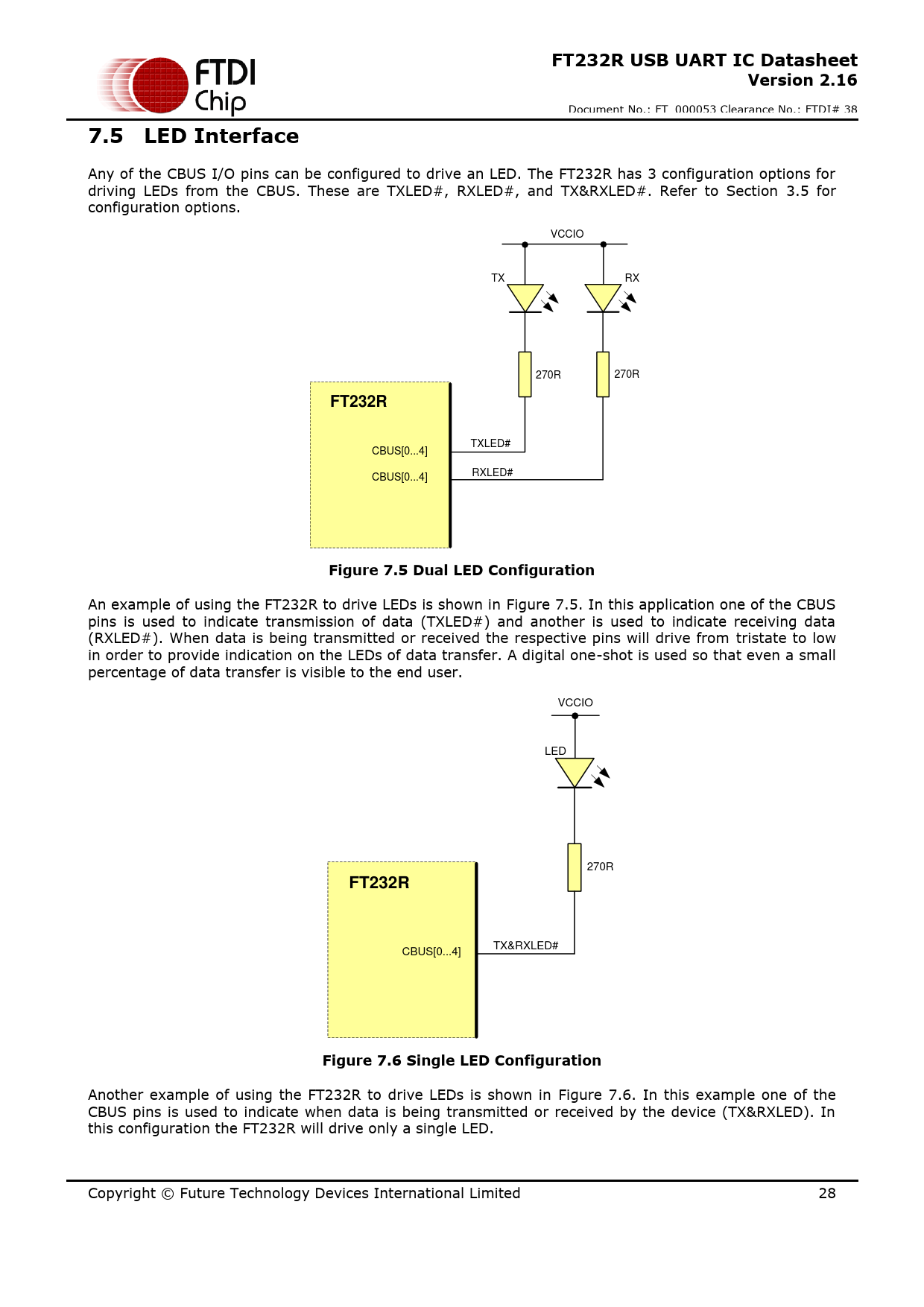

Any of the CBUS I/O pins can be configured to drive an LED. The FT232R has 3 configuration options for driving LEDs from the CBUS. These are TXLED#, RXLED#, and TX&RXLED#. Refer to Section 3.5 for configuration options. VCCIO TX RX 270R 270R
FT232R
TXLED# CBUS[0...4] CBUS[0...4] RXLED#
Figure 7.5 Dual LED Configuration
An example of using the FT232R to drive LEDs is shown in Figure 7.5. In this application one of the CBUS pins is used to indicate transmission of data (TXLED#) and another is used to indicate receiving data (RXLED#). When data is being transmitted or received the respective pins will drive from tristate to low in order to provide indication on the LEDs of data transfer. A digital one-shot is used so that even a small percentage of data transfer is visible to the end user. VCCIO LED 270R
FT232R
TX&RXLED# CBUS[0...4]
Figure 7.6 Single LED Configuration
