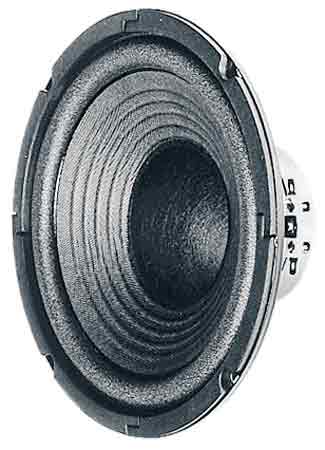

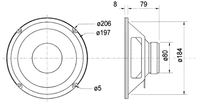

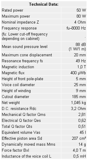

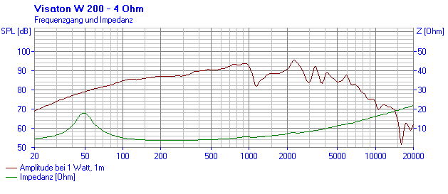

Динамик НЧ Visaton W 200/4
20 cm (8") woofer with very good price/performance ratio.
BASS SPEAKER, 8", 4 OHM | |||
W200-4OHM Visaton | от 4 993 ₽ |
Suitable for simple 2-way speakers and car rear tray systems. Especially suited as replacement driver for many HiFi speakers.
