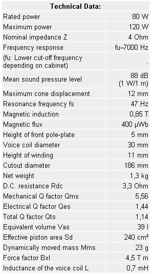

20 cm (8") HiFi woofer with polypropylene cone.
Элитан
WS-20-E-8-OHM
Visaton
5 479 ₽

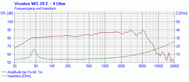

Due to balanced frequency response curve suitable as low-midrange driver for large 4-way speaker systems. Due to the special basket design suitable as replacement driver for many HiFi speakers.
