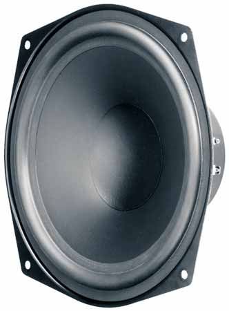

Динамик НЧ Visaton WS 20 E/8
20 cm (8") HiFi woofer with polypropylene cone.

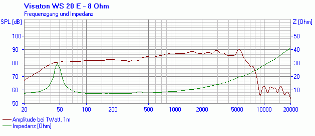

Due to balanced frequency response curve suitable for 2-way-applications up to 2000 Hz and as low-midrange driver for large 4-way speaker systems as well. Due to the special basket design suitable as replacement driver for many HiFi speakers.
