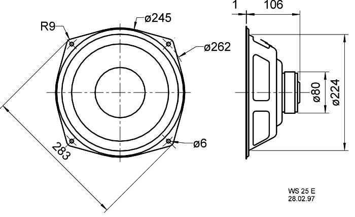

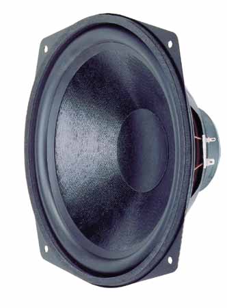

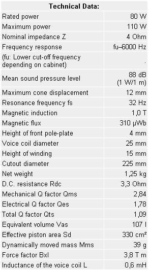

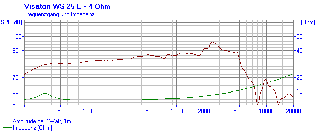

Динамик НЧ Visaton WS 25 E/4
25 cm (10") woofer with coated paper cone, rubber edge and extended rear pole plate for long strokes.
WS-25-E-8-OHM Visaton | 9 556 ₽ |
Due to the basket design especially suited as replacement woofer for many standard HiFi speakers.
