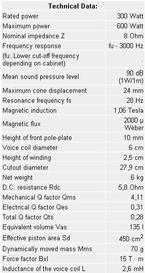

30 cm (12") High-End woofer with black cellulose cone, large magnet and heavy aluminium die-cast basket.
Extremely high power handling due to 60 mm voice-coil, capton voice coil carrier, vented damper and magnet vent.

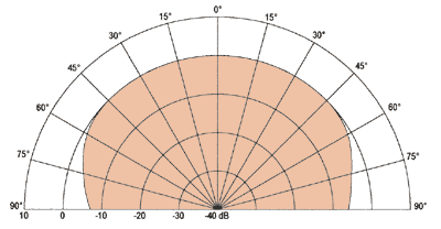

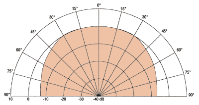

radiation pattern 500 Hz

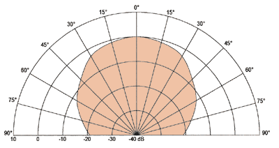

radiation pattern 1000 Hz

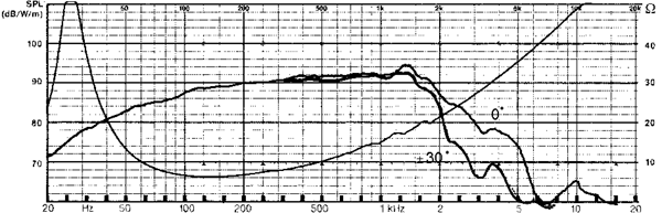

radiation pattern 2000 Hz
