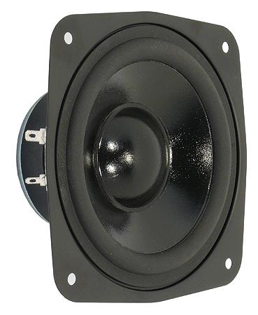

Динамик СЧ/НЧ Visaton W 130 SE/8

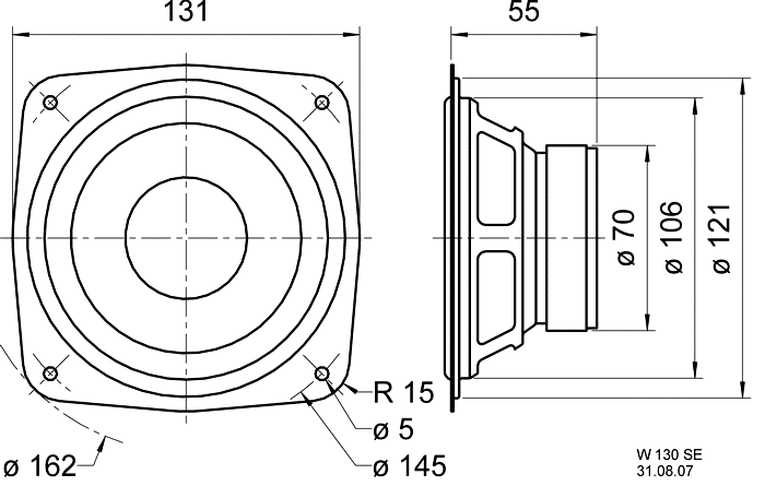

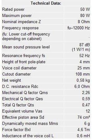

13 cm (5") HiFi low-midrange driver with flat basket edge, coated paper cone, elastic rubber surround and 25 mm voice-coil.
Suitable as woofer and due to the very balanced frequency response also as low-midrange driver especially in large 3-way speaker systems.
