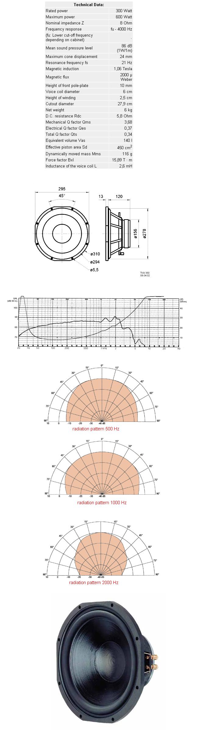

Динамик НЧ Visaton TIW 360 X/8
30 cm (12") High-End woofer with a particularly low resonance frequency.
Double cellulose cone, large-scale magnet arrangement and a heavy die-cast aluminium basket. Excellent power-handling capabilities with minimum mechanical power loss due to the 60 mm voice coil mounted on a capton coil carrier, the pressure vented pole piece and the rear-vented damper. Particularly suitable for closed cabinets and transmission line applications.
