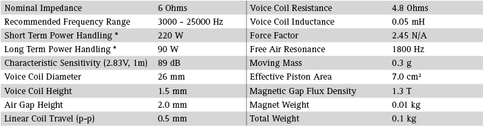

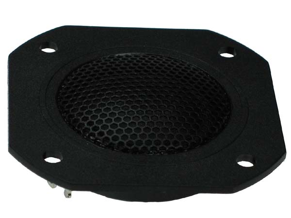

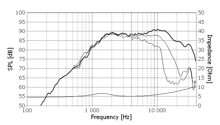

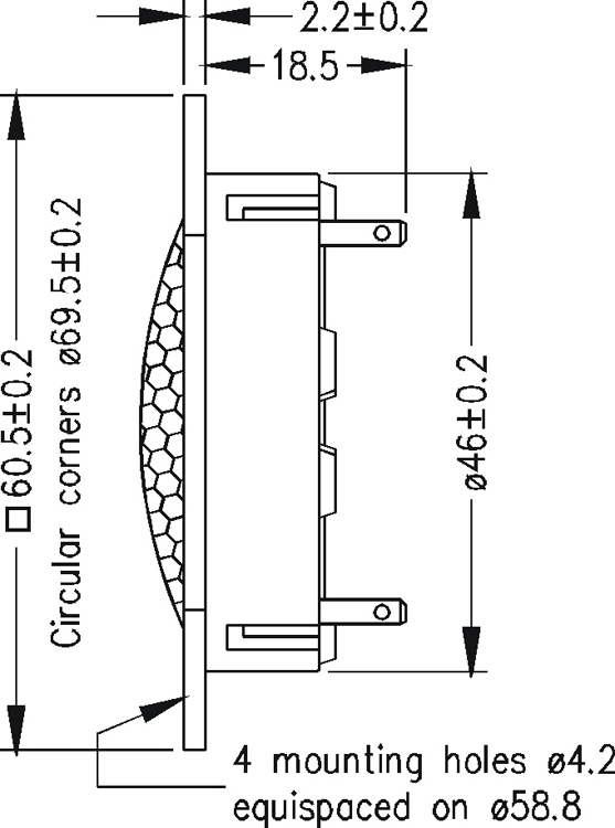

Compact neodymium magnet tweeter with a square chassis for high quality speaker design in small cabinets or automobiles.
Precoated Sonotex fabric diaphragm and suspension allows for very tight production tolerances and high consistency. A Hexagrid protects the diaphragm. Very low magnetic stray fields make this unit suitable for A/V systems. Voice coil immersed in magnetic fluid, allowing high power handling capacity and simplified crossover design.
