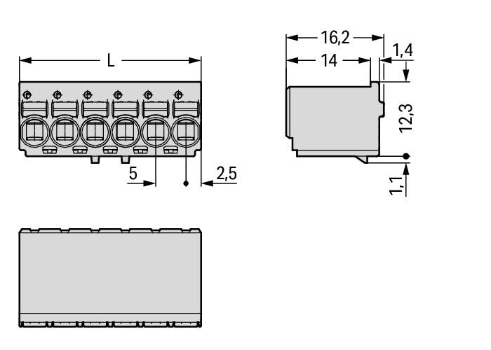

1-проводниковая розетка; 2,5 мм²; Шаг контактов 5 мм; 12-пол.

Габариты: глубина13.4 mm / 0.528 inch
Fine-stranded conductor0.2 … 2.5 mm² / 24 … 12 AWG
Fine-stranded conductor with ferrule with plastic collar0.25 … 1.5 mm²
Fine-stranded conductor with ferrule without plastic collar0.25 … 2.5 mm²
Fire load0.262 MJ
Flammability class per UL94V0
GTIN4050821163541
Height16.2 mm / 0.638 inch
Insulating materialPolyphtalamide (PPA GF)
Legend (ratings)(III / 2) ≙ Overvoltage category III / Pollution degree 2
Limit temperature range-60 … +100 °C
Material groupI
Mismating protectionNo
Number of Poles12
Number of connection types1
Number of levels1
Pin spacing5 mm (0.197 inch)
Product Group26 (picoMAX)
Rated current16 A
Rated impulse voltage (II / 2)4 kV
Rated impulse voltage (III / 2)4 kV
Rated impulse voltage (III / 3)4 kV
Rated voltage (II / 2)630 В
Rated voltage (III / 2)320 В
Rated voltage (III / 3)250 В
Solid conductor0.2 … 2.5 mm² / 24 … 12 AWG
Strip length9 … 10 mm / 0.35 … 0.39 Inch
Total number of connection points12
Total number of potentials12
Вес11.12 г
Ширина60 mm / 2.362 inch
