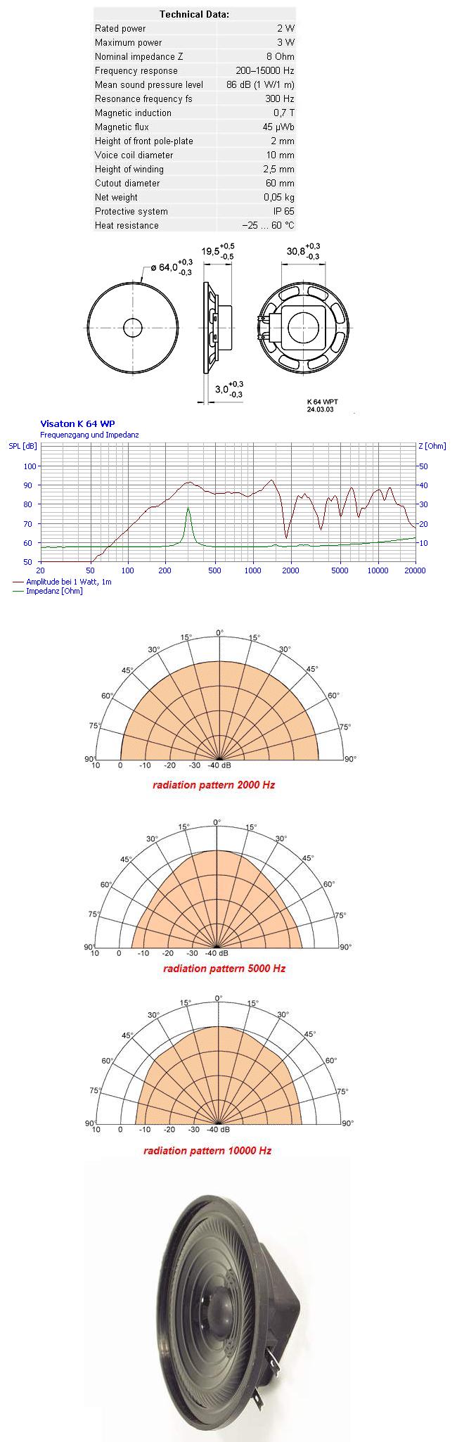

Динамик широкополосный Visaton K 64 WPT/8
6.4 cm (2.5") full-range speaker with a plastic basket and plastic diaphragm.
Broad frequency response and good voice reproduction. Particularly well suited to outdoor applications and where ambient conditions are generally unfavourable (e.g. high humidity).
Typical applications:
- Monitoring speaker for electronic devices
- Monitoring speaker for outdoor systems
Attributes:
- Weather-resistant
- UV-resistant
- Plastic: ABS (basket; UL 94: HB); Mylar (diapraghm)
- Functionally at cold according to EN 60068-2-1/EN 50155
- Cold storage (-40 °C) according to EN 60068-2-1/EN 50155
- Functionally at damp heat (cyclic) according to EN 60068-2-3/EN 50155
- Functionally at dry heat according to EN 60068-2-2/EN 50155
