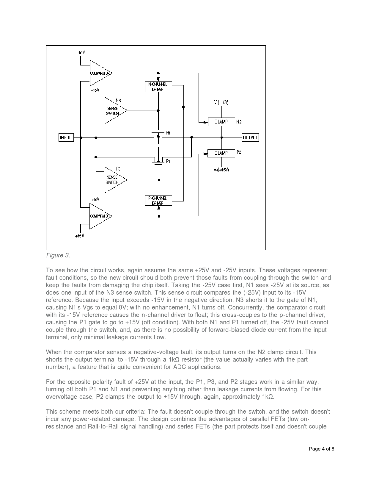

Figure. 3. To. see. how. the. circuit. works,. again. assume. the. same. +25V. and. -25V. inputs. These. voltages. represent. fault. conditions,. so. the. new. circuit
Figure 3 To see how the circuit works, again assume the same +25V and -25V inputs These voltages represent fault conditions, so the new circuit
Текстовая версия документа
