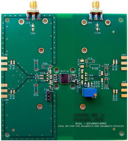

EVAL-ADUM5010EBZ

Analog Devices - EVAL-ADUM5210EBZ
